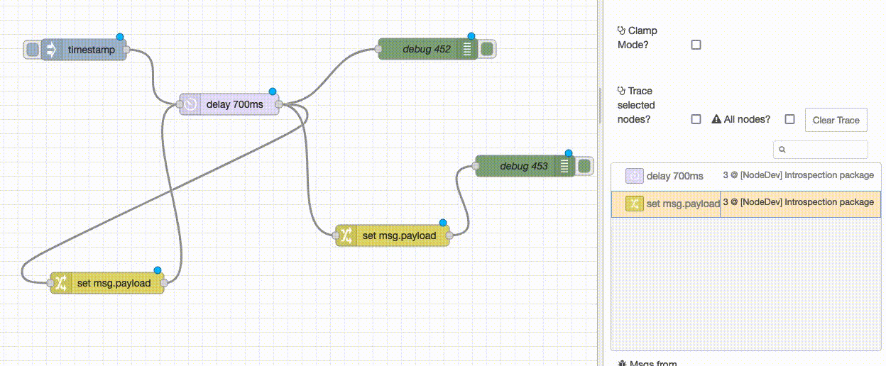

Message tracing
Sometimes it would be nice to observe the flow of messages through a flow. This is possible by using 'Trace Messages' found at the bottom of the 'Lint' tab:
Message tracing can be toggled on & off without redeploying the flow. So this can be used as a quick check for observing tricky situations.
The nodes status will be replaced by 'msg received', so if the status should be showing something else, that will be replaced.
Also this is an experimental feature liable to be enhanced.
UPDATE:
This now has a treeList of nodes and how often they received a message. Clicking on the node in the list will highlight the node, double-click will open the nodes edit panel.
UPDATE TWO:
It is now possible to send all messages to the debug panel. By toggling the 'msg to debug' checkbox, all messages will be sent to the Node-RED debug panel. This can be toggled on and off independently of the message tracing. That is, as long as message tracing is activated. It is therefore possible (as shown in the animation above) to active message tracing, then activate msg to debug to have msg appear in the debug panel and then deactive the msg to debug. The message tracing continues unabated.
This makes it possible to trace messages, if something critical happens, to activate the msg to debug and then deactivate again. Only those messages that occured in that timeframe are logged.
But remember all messages are logged to the debug panel, every single message that is sent within Node-RED will be set to the debug panel. This will cause major disappointments for those wishing to have a responsive editor.
Also this feature causes no extra overhead on the backend server if it is not in use - the hooks for capturing the data are removed if this feature is deactivated.

Clamp Mode
This idea is 100% from @AllanOricil and I stole that idea from him - all kudos to him, all bugs to me!
Clamp mode allows highlighting individual wires and tracing the messages that go over that wire. Only single wires are allowed and unhighlighting the wire will deactivate the message trace.
BE WARNED: this can and will flood your Node-RED frontend to non-responsiveness, there is no inbuilt back-off, message limits or anything else that might or might not prevent bad things from happening.

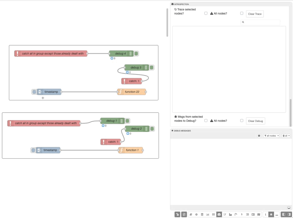

Message Tracing in Node-RED 5.x
Node-RED version 5 offers a split-pane view, which is particularly advantageous for message tracing. Now it is possible to open the message tracer pane to see the individual nodes receiving messages and at the same time open the debug pane to see the debug notices from those nodes.
It is possible to trace nodes and have their messages, as they receive them, pushed to the debug panel. This works really nice in Node-RED 5.x because there the two panels can be opened at the same time. That is not possible in Node-RED 4 or 3, so you end up constantly switching between the panels - the debug and introspection panels.
A BIG caveat here is that it's very easy to flood the Node-RED editor with excessive messages. If there are flows that are generating a lot of messages, be aware of using debug or trace ALL nodes - that can lead to flooding. If in doubt, start with one or two nodes or a small selection of nodes, and trace those first. Then gradually increase the number of nodes being traced.
This is something that I can not say strenuously enough!!! It is all too easy, if you do select all nodes, to be surprised by flows that you have working in the background and that generate lots of messages. I've been there many a time and have had to reload my editor after switching off the message tracing so that it didn't flood my editor. So it's always good to deactivate the message tracing as quickly as possible and not to leave that on.
That's also another thing that I've noticed: sometimes I would leavethe message tracing on for too long, and only I realize that once the editor got flooded. That is also simpler in Node-RED 5.x because you can keep that panel open while switching between the debug nodes. This is what always happened to me because I switched between the debug and the message tracer panel and then forgot that I left the tracing on, as I had headed off to the debug panel. So in Node-RED 5, that's a little bit nicer because you can keep that panel with the message tracing open and then switch off tracing as needed.
Message Tracing Fail Safe
Because of the risk to freezing the editor, a fail safe in message generation has been added.
If the message tracing detects more than 100 messages per second, then the message tracing is deactivated automatically. One hundred messages per second is a default value and can be modifed in the browser console using window.msgTracer_MAX_MSG_PER_SECOND = 100.
Message counts include the debug message generated and the message tracing shown in the sidebar.
