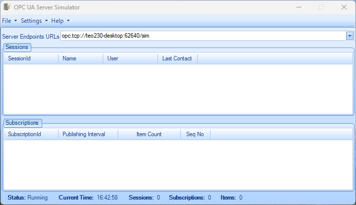

  1. Start the OPC UA Server Simulator and copy the Server Endpoints URLs url
drawing

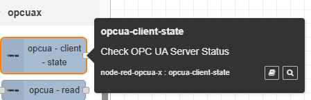

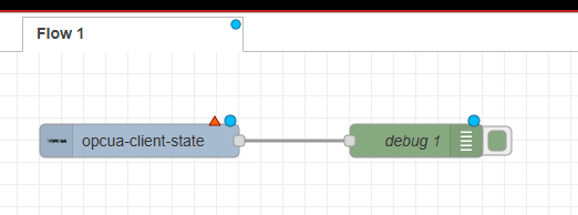

  1. Select the opcua-client-state or just import the client-state.json sample
drawing drawing

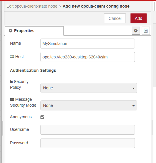

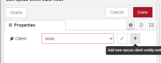

  1. Open the opcua-client-state node and setup the client with endpoint, name, username, ...
drawing drawing

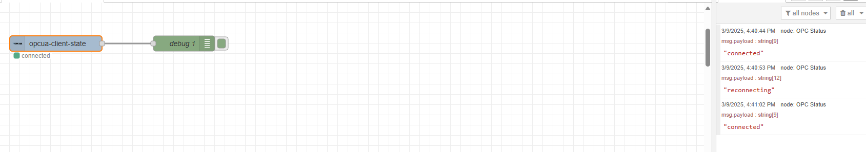

  1. Deploy the flow!
drawing
