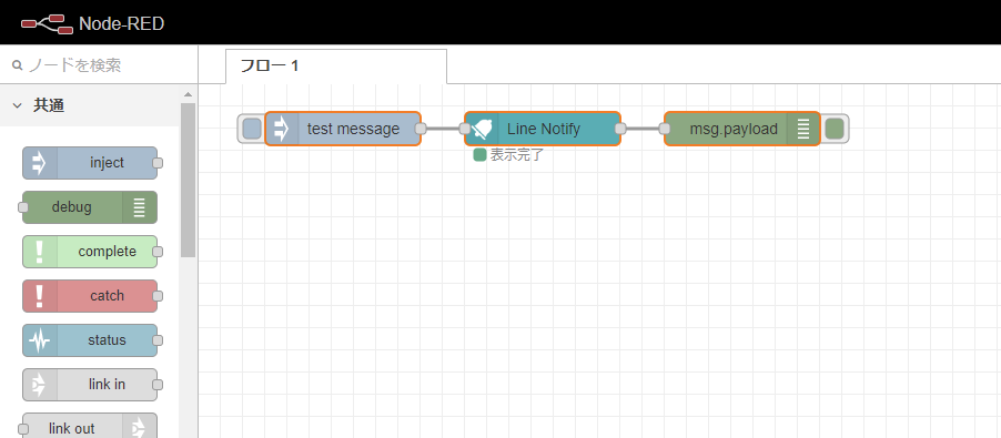

node-red-contrib-line-notify-api 1.0.0
This is a Node-RED node for using "LINE Notify API". the NODE-RED node supports sending "message", "stamp" and "image".
npm install node-red-contrib-line-notify-api
