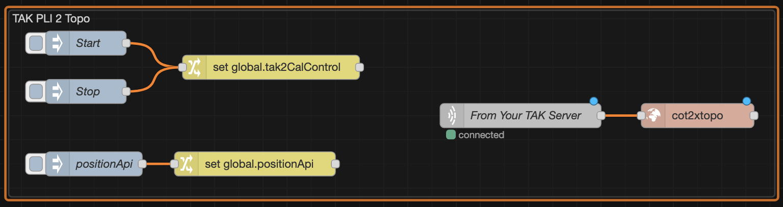

Parses CoT message from a stream, parses for PLI messages for coordinates and callsign, and then sends a location to CalTopo using the API and connect key generated by team accounts

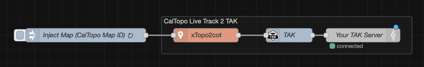

This Node RED subflow listens in on a network kml file such as the one produced by a CalTopo Team account map, parses out the position location information (PLI) of personnel and streams the cursor on target message to a TAK Server or multicasts to via UDP on a virtual private network.

  1. INJECT: The msg.payload should be set to the CalTopo Map ID, which would be the last 5 characters of your CalTopo URL. For example, if your map url is https://sartopo.com/m/ABC12, the map id would be ABC12.
  2. node-red-contrib-tak: This node is required to pass the CoT message from this subflow to a TAK Server or EUDs on a network.
  3. TCP OUT:
    • TAK Server: If using TLS, check on the SSL / TLS option and create or edit your TLS Configuration, as needed.
    • UDP: This would need to be configured to your vpn settings and requires your Node Red instance to be on the same vpn to multicast to TAK end-user-devices.
For more information on how to set up the network and node-red-contrib-tak nodes, see https://node-red-contrib-tak.readthedocs.io/en/latest/

  1. Import subflow json files in the ./examples subfolder into to Node-RED
  2. Install using npm: npm i node-red-contrib-cot2xtopo
