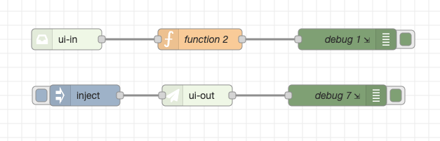

Beacons
File: examples/beacons.json
Beacons flow
Receives and transmits AX.25 UI frames using the ui-in and ui-out nodes. Demonstrates APRS-style beacon monitoring and periodic transmission.

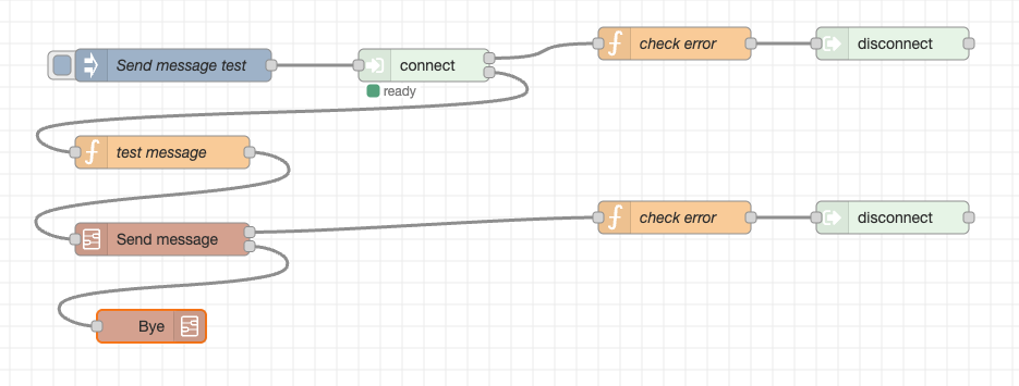

Send message test
File: examples/send_test_message.json
Send message test flow
A complete flow that connects to a packet BBS, composes and sends a test message using the Send message subflow, and disconnects via the Bye subflow. Demonstrates end-to-end message delivery from connection through graceful teardown.

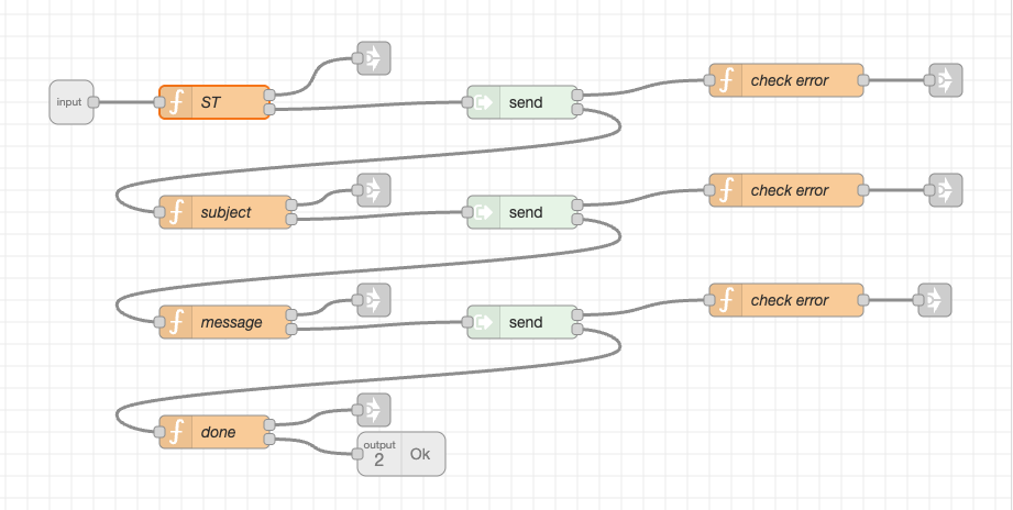

File: examples/send_message_subflow.json
A reusable subflow that composes and sends a message to a packet BBS: sets the addressee, subject, and body via a sequence of send nodes, each waiting for the BBS prompt before advancing.

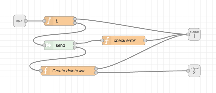

Get message list subflow
File: examples/get_message_list_subflow.json
A reusable subflow that retrieves the message list from a packet BBS using the send / waitFor pattern and returns a parsed list.

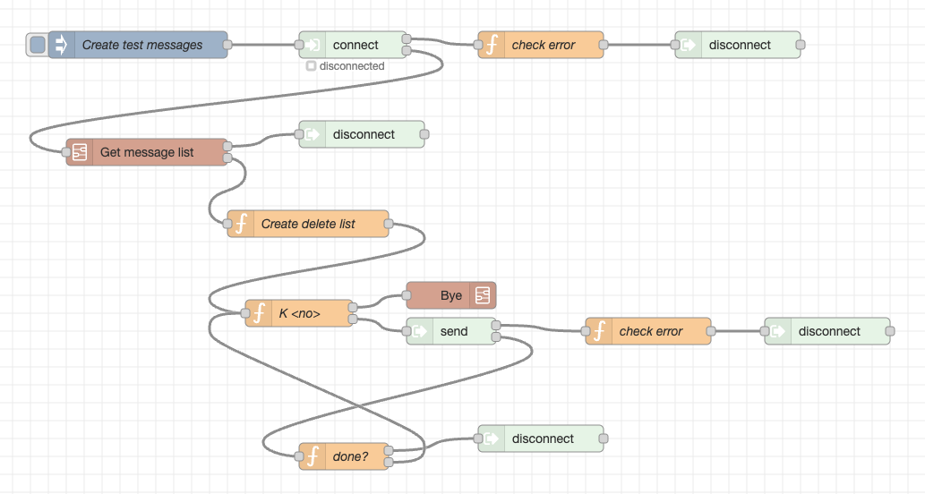

Delete all my messages
File: examples/delete_all_my_messages.json
Delete all my messages flow
A full flow that connects to a packet BBS, retrieves the message list using the Get message list subflow, deletes every message addressed to the registered callsign, and disconnects cleanly. Demonstrates composing subflows into a complete automated task.

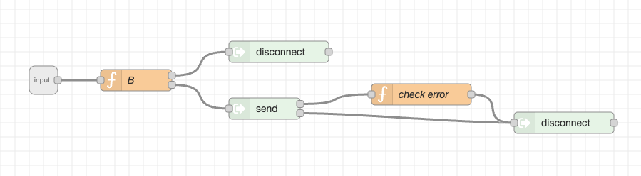

Bye subflow
File: examples/bye_subflow.json
Bye subflow
A reusable subflow that sends a BYE command and waits for the BBS to close the session gracefully. Intended to be composed into larger BBS flows.

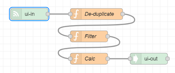

APRS calc example
Bye subflow
This flow create a trivial example APRS service. Send an APRS message to the destination calc with the message an arithmetic expression. The aprs_calc service will evaluate the expression and return the answer as a message to the original sender.
