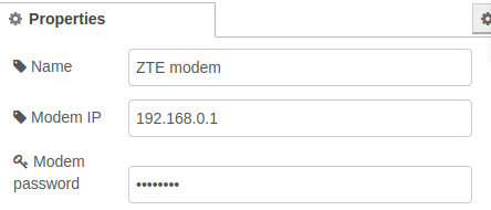

Modem properties
Nodes (except for filter node) require modem configuration. modem-properties
  • Name: Name of the modem
  • Modem IP: ZTE modem IP
  • Modem password: password for the ZTE modem

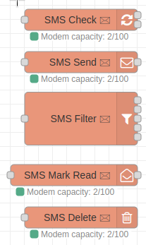

zte-sms-send node
Nodes sends the SMS message to selected number. Sent SMS is stored on modem and as modem has limited capacity of messages, consider deleting the sent message by wiring the output of this node into zte-sms-delete, to delete the SMS from mode after it was sent.
  • Name: Name of the node
  • Modem: select modem configuration
  • SMS message: select to either send whole or part of the incoming node message as SMS
  • Phone number: phone number of the SMS recipient
Optionally you can define phone recipient number also through incoming node message instead of defining it in properties, by adding recipientNumber key.
  payload: "your payload",
  recipientNumber: "123456789"
zte-sms-delete node
Node deletes the SMS messages from modem storage. It's necessary to use this node or modem will eventually run out of SMS storage capacity.
Node will delete the SMS messages by message id. For convenience, output data structure of other zte-sms nodes is already in the correct format so you can just pipe the output of those node into this one.
  sms: [ { id: '12', ... }, { id: '13' }, ... ]
zte-sms-check node
Node checks for SMS messages stored on modem and will return all the messages. This includes sent, received unread, received read, drafts, send failed. Node will check for messages on each input, so you can have an inject node configured to ping this node every 5s or every 10min. Up to you. Node has 2 outputs. First is array of all messages stored on modem, second one is modem capacity. For convenience, modem capacity is also displayed as status on every zte-sms node that has modem configured.
zte-sms-filter node
This is a convenience node that doesn't require modem configuration, but can be helpful to filter messages from zte-sms-check node.
  • Phone number: filter messages for allowed numbers. To specify 2 or more allowed numbers, delimit them with ;
Node has 6 outputs, that filters SMS messages by it's type.
  • 1st output: Read received SMS
  • 2nd output: Unread received SMS
  • 3rd output: Sent SMS
  • 4th output: Failed sent SMS
  • 5th output: Draft SMS
  • 6th output: Unfiltered
If you specified allowed phone number(s), 6th output (Unfiltered) will include messages from not allowed numbers, so you can potentially delete them. SMS messages from allowed number(s) will be filtered based on SMS type in first 5 outputs.

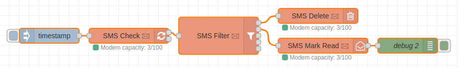

Example flow 2
Periodically check for messages with zte-sms-check node, pipe output to zte-sms-filter node (optionally limit the output to only allowed numbers), pipe already read SMS messages to zte-sms-delete node, pipe unread SMS messages to zte-sms-mark node to mark them as read, then do something with these new received messages. flow-1
