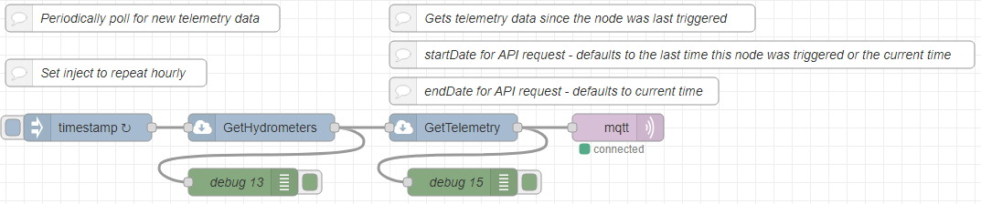

For example, to get all new telemetry information hourly, you could wire an inject node, set to repeat every hour, into a rapt-pull node configured for GetHydrometers, then wire the output of that node to another rapt pull node configured for GetTelemetry, as shown in the example below. In this configuration, the node configured for GetTelemetry will retrieve the telemetry data for the period since it was last invoked.
example1

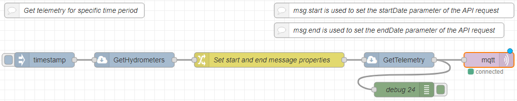

Alternatively, you could get telemetry information for a specific time period by inserting a change node to set the start and end properties of the message before the rapt-pull node configured for GetTelemetry, as shown below.
example2
