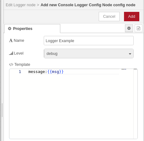

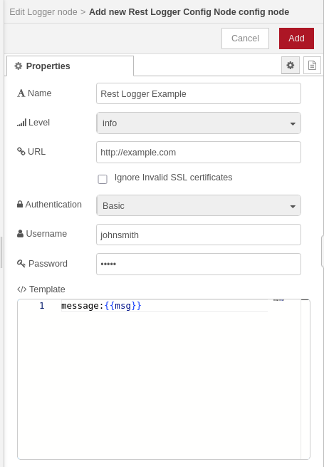

Creating a logger provider:
Extend LoggerConfigNode and tag it so the NodeTypeService can discover it:
import { LoggerConfigNode, ConfigNodeConfig, NodeDescription, SourceUtility }
    from "@theotherwillembotha/node-red-plugincore";
interface ConsoleLoggerConfig extends ConfigNodeConfig {
    level:    string;
    template: string;
@NodeDescription({
    group:      "logging",
    sourceFile: SourceUtility.getSourcePath("/build/", "/src/") + "ConsoleLoggerConfigNode.html",
    package:    "@myscope/node-red-logging",
    tags:       ["LoggerType"],   // <-- required: makes this discoverable as a logger provider
class ConsoleLoggerConfigNode extends LoggerConfigNode<ConsoleLoggerConfig> { ... }
The "LoggerType" tag is what causes this node to appear in the Logger dropdown of any node using LoggerTemplate.

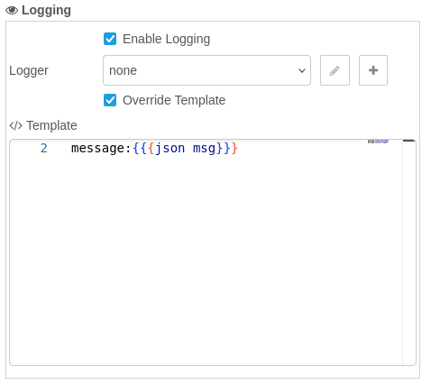

Screenshot - LoggerTemplate section (as it appears inside a consumer node's editor):
Logger Template
The Logging section injected by LoggerTemplate. The enable toggle controls whether log calls are forwarded to the provider. The Logger dropdown lists all installed logger providers, with edit (pencil) and create (plus) buttons. Override Template allows per-node customisation of the log format.

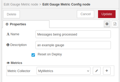

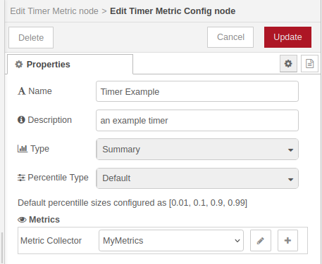

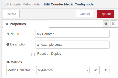

Dedicated metric flow nodes (v0.4.0)
For nodes whose primary purpose is metric collection, v0.4.0 introduces dedicated metric templates. Flow nodes own their metrics directly - no intermediary MetricConfigNodes.
Template Config Interface ConfigFragment Section Factory Method
CounterMetricTemplate CounterMetricTemplateConfig CounterMetricConfig createCounter()
GaugeMetricTemplate GaugeMetricTemplateConfig GaugeMetricConfig createGauge()
TimerMetricTemplate TimerMetricTemplateConfig TimerMetricConfig createTimer()
Each template includes a provider selector, "Reset on Deploy" checkbox, and add/edit buttons. Used alongside ConfigFragmentTemplate for provider-specific UI (e.g. Prometheus description, histogram buckets).
The nodered_telemetry plugin provides ready-made Counter, Gauge, and Timer metric flow nodes using this pattern. The nodered_prometheus plugin provides PrometheusMetricsConfigNode (the provider) plus ConfigFragments for all three metric types.

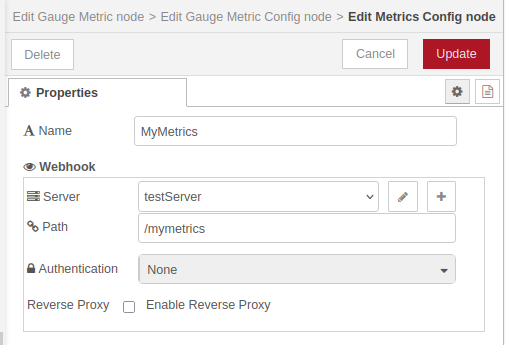

Webhook
The webhook subsystem provides a shared Express v5 HTTP server that multiple nodes can register routes on.
Part Role
WebhookServerConfigNode Config node (provided by plugincore itself). Runs the HTTP server on a configured port.
@Webhook() Property decorator. Registers public methods (get, post, put, delete) as HTTP routes with the referenced WebhookServerConfigNode.
WebhookTemplate UI template. Adds a webhook server selector and path field to the node editor.

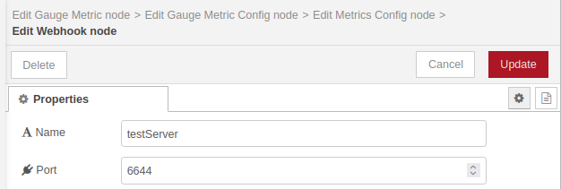

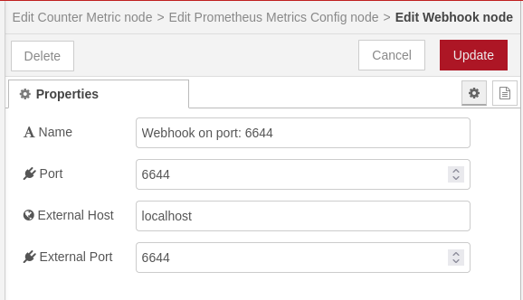

Webhook Server config node:
Webhook Server Config Node
The Webhook Server config node. Name is a human-readable label shown in the Server dropdown of any node using WebhookTemplate. Port is the local TCP port the Express server listens on - each server instance must use a unique port. External Host and External Port allow consumer plugins (e.g. Reolink) to construct publicly-visible callback URLs when the server sits behind a reverse proxy or is accessed from an external network.

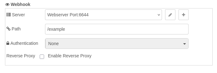

Screenshot - WebhookTemplate section (as it appears inside a consumer node's editor):
Webhook Template
The Webhook section injected by WebhookTemplate. Server is a dropdown that lists all WebhookServerConfigNode instances, with edit and add buttons. Path is the HTTP route registered on that server (e.g. /example). Authentication selects the credential strategy - None, Basic Auth, or API Key - and reveals the relevant credential fields when a strategy other than None is selected. Reverse Proxy is hidden unless a reverse proxy provider plugin (e.g. node-red-nginxproxymanager) is installed; when shown, it lets you map the webhook path to a public-facing domain.
