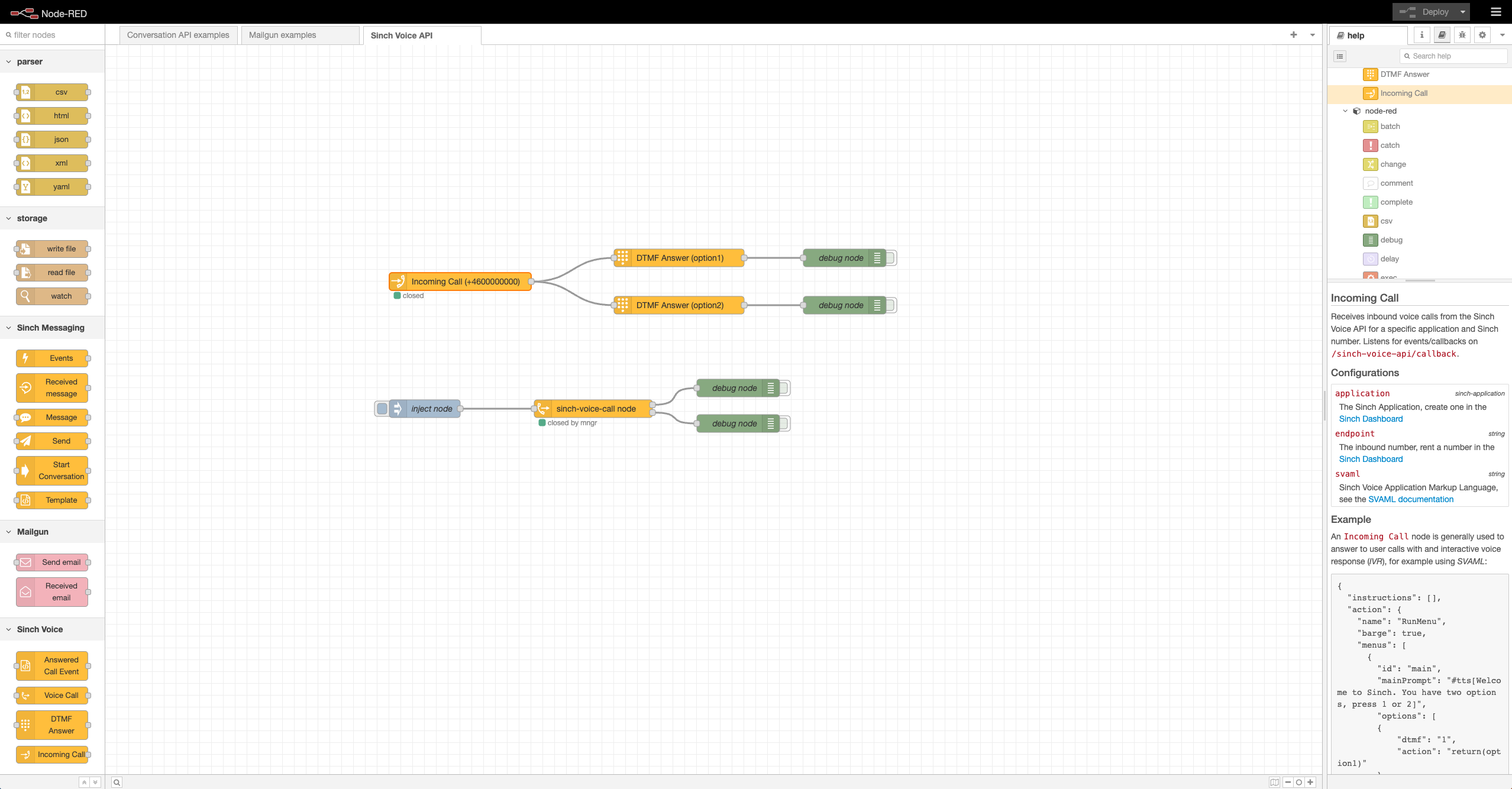

After you've installed Node-RED and the @sinch/node-red-voice-api package you can start building your flow. To get you started we provide an example flows.json containing the essentials for initiating and receiving voice calls. To import the flows.json file, open Node-RED in the brower and select the hamburger menu in the top right corner. Choose "Import" and press "select a file to import". The flow file will then be imported on a tab called "Example flow".
The flow.json contains two separate flow examples. For each of the flows there exists a comment node containing additional information about the configuration required to test it out.

Incoming Call node
Handles and routes inbound voice calls from the Sinch Voice API for a specific application and Sinch number.
In order to receive calls from the Sinch Voice APi, you need to configure a Callback URL on the voice application in the Sinch dashboard. The path should be: <node-red-path>/sinch-voice-api/callback.
Voice Call node
Initiates an outbound voice call using the Sinch Voice API.
In order to initiate calls from the Sinch Voice APi, you need to configure a Callback URL on the voice application in the Sinch dashboard. The path should be: <node-red-path>/sinch-voice-api/callback.
DTMF Answer
Captures the DTMF (Dual Tone Multi Frequency) keypad (0-9, * and #) input from the user response.
Answered Call Event (ACE)
Stores a SVAML for a call (inbound or outbound) in case of an ACE (Answered Call Event).
