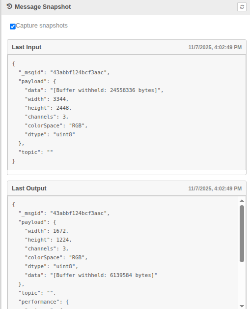

  3. A Message Snapshot card appears with two sections:
    • Last Input: the most recent message the node received.
    • Last Output: the most recent message it sent.
  4. Use the refresh button on the card to re-fetch without changing selection.
Snapshots use a clean format: large payloads are summarised, but every placeholder includes the original length so you can judge the size at a glance.
