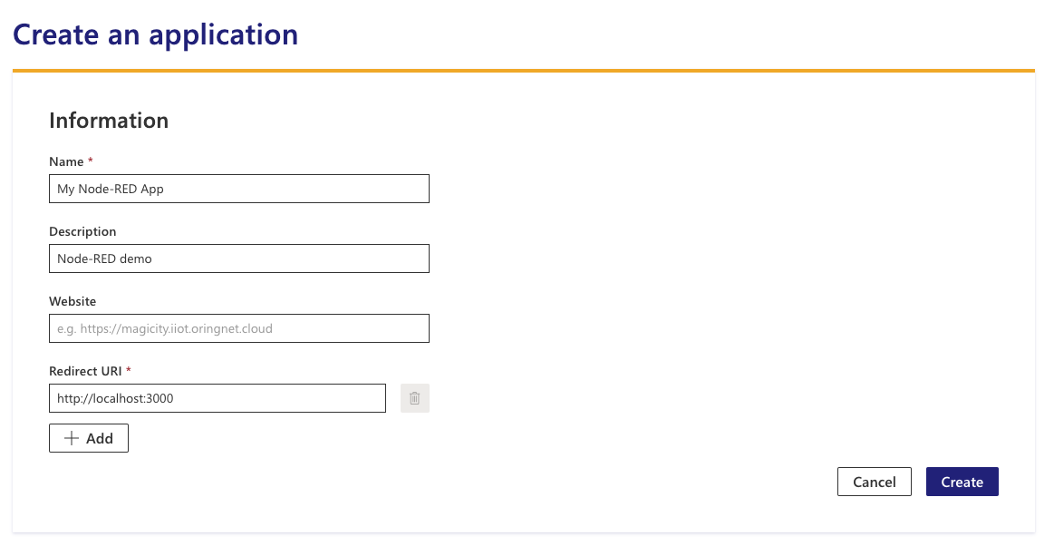

Step 1: Create an application on the ORing PaaS
create-an-app

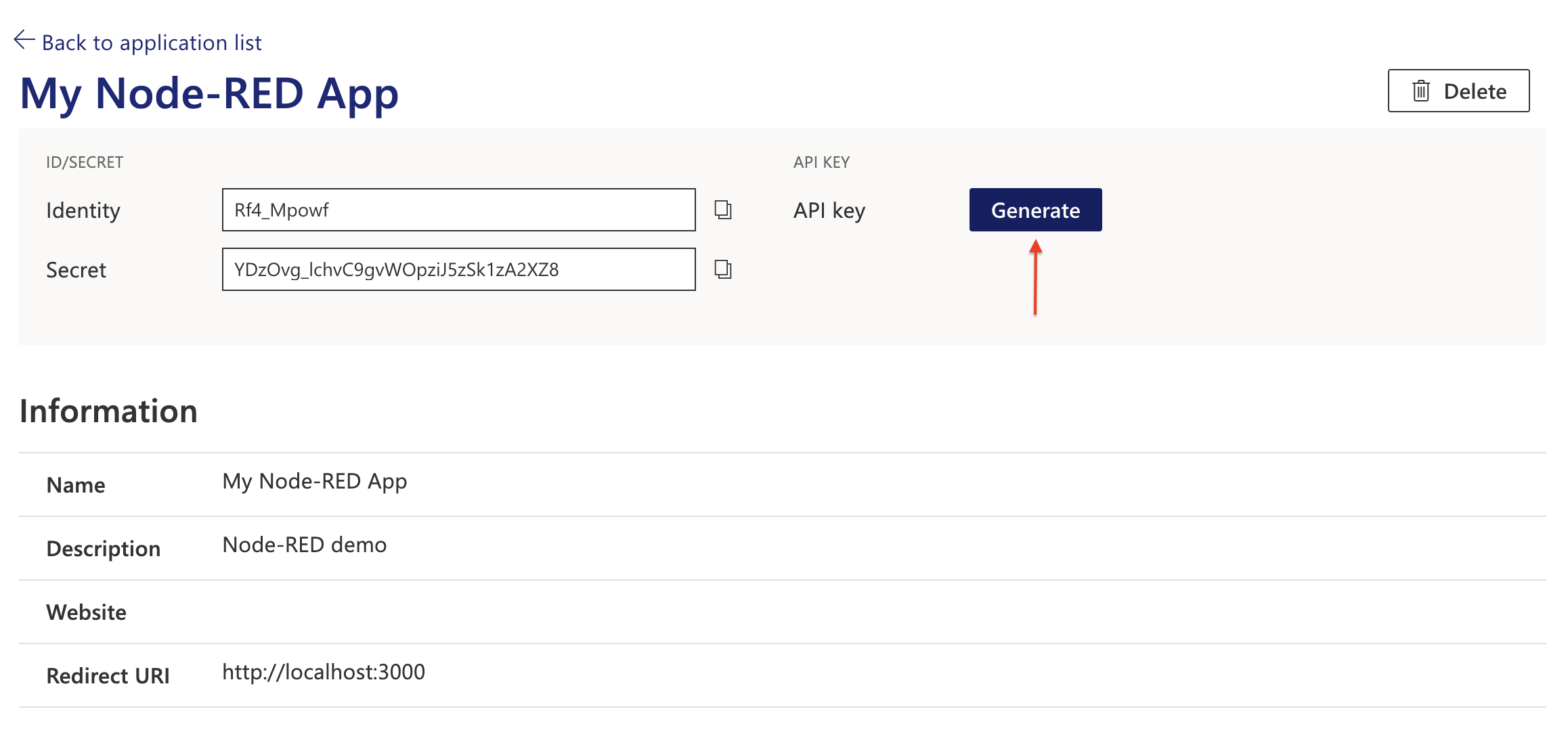

Step 2: Generate an API Key
generate-an-api-key

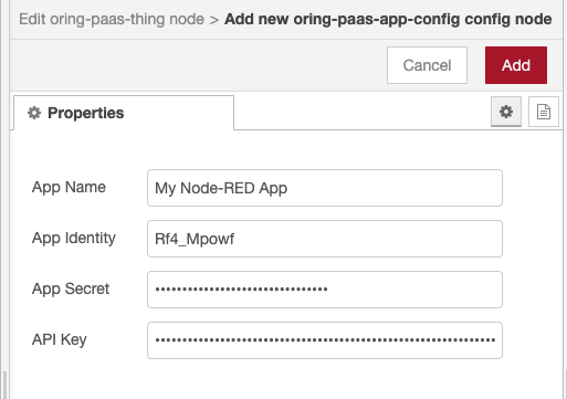

Step 3: Add a new app config to the oring paas thing node
add-app-to-node

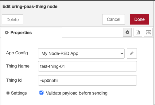

Step 4: Copy the thing identity and name to the oring paas thing node
copy-thing-info
Deploy the node then you should see the node status is connected.
connected-node

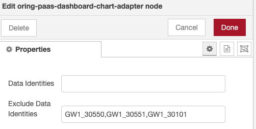

Step 2: Add oring paas dashboard chart adapter node to the flow
The node can be configured to include/exclude specific data identities.
oring-paas-dashboard-chart-adapter-config

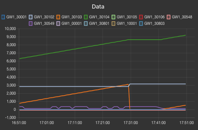

The node will convert oring paas thing node output into dashboard chart node input.
oring-paas-thing-node-to-dashboard-chart-adapter-node
If set up correctly, a real-time chart will be displayed on the dashboard.
dashboard-chart-result

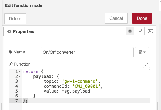

Step 2: Add a function node to convert switch on/off into a valid input
on-off-convert-example
The oring paas thing node input example:
  "topic": "gw-1-command",
  "commandId": "GW1_00001",
  "value": true

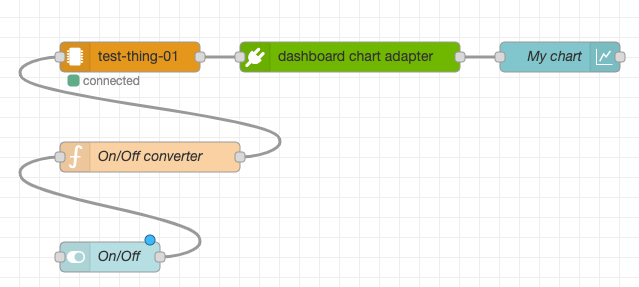

The flow should look like this:
sending-command-flow-example
After the switch being toggled, the command will be sent to $thing/{thingId}/$cmd/$downlink/gw-1-command topic with the following payload:
  "id": "GW1_00001",
  "value": true
