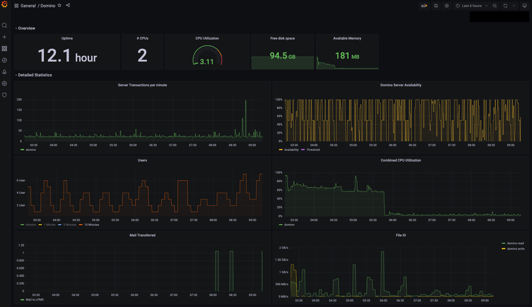

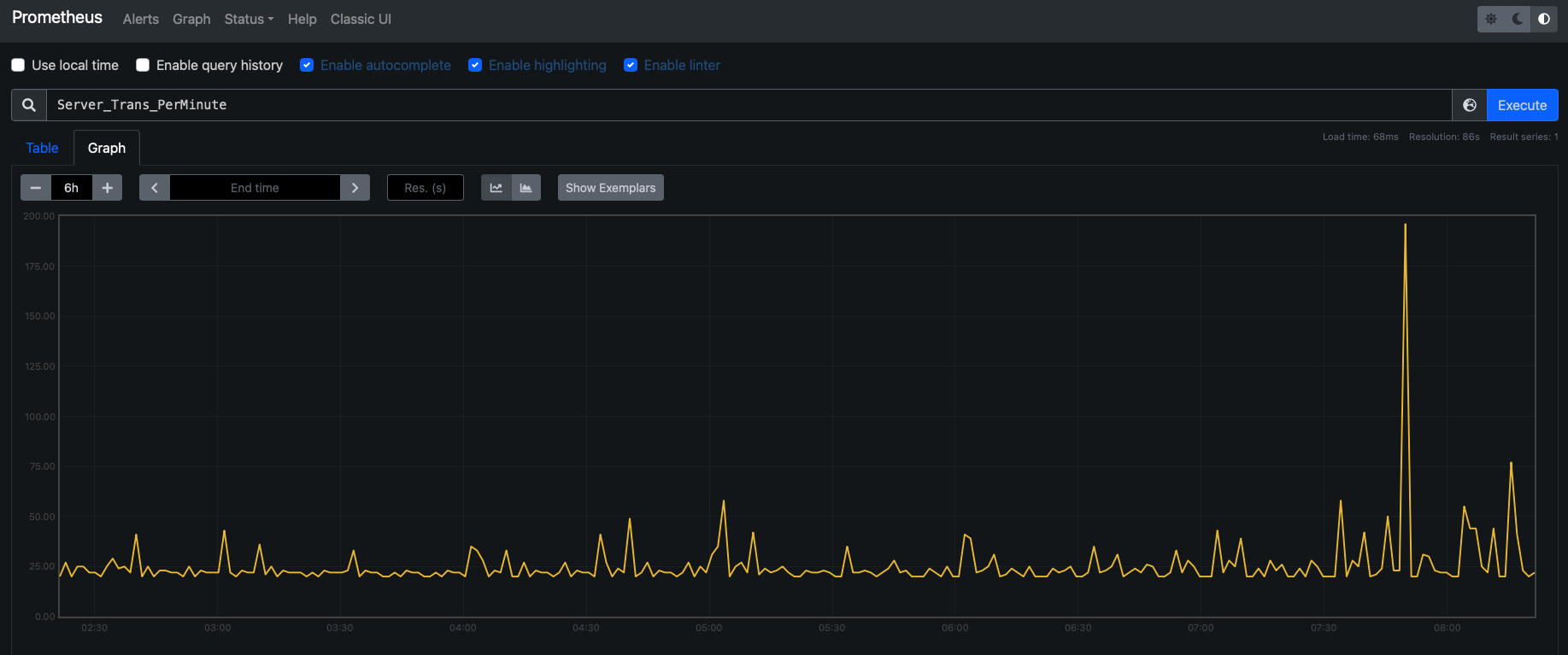

In this workaround we will have a HCL Domino server post statistics to a URL on a Node-Red instance every minute. We will transform the data so it matches a Prometheus metrics scrape file. The data will be stored in a local file. Whenever Prometheus scrapes for new data, the cached data will be loaded from the local file. This will allow Prometheus to store the Domino statistics in its time series database. You can then use these statistics in a Grafana dashboard.
